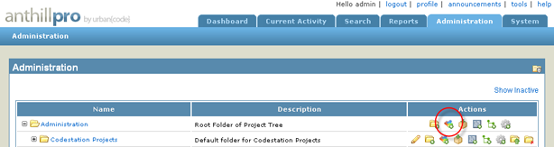

To create a new project:
  1. Go to the Administration page click the New Project icon.
  2. On the Create a Project page, check the Life-Cycle Based project and click Select. In AnthillPro, it is the Life-Cycle Based project that is used to run a build.

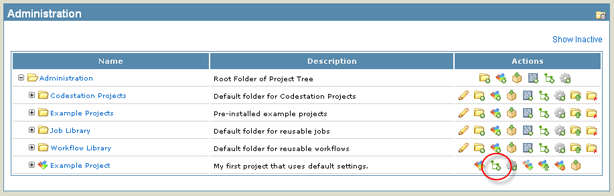

  1. Select the Add Workflow icon of your new project.
  2. Next, check Originating workflow and click Select on the New Workflow page. In AnthillPro, it is the Originating workflow that is used to run build. Non-Originating workflows are secondary processes (such as deployments) that can be run on the build.

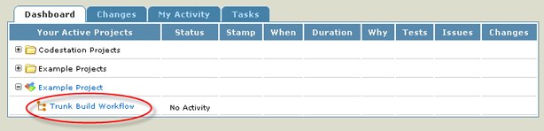

  9. The next time your build runs, the artifacts will be delivered to the AnthillPro artifact management system. (If you like, you can force a manual build.) This will make the artifacts available on the Dashboard.
    To view the artifacts, go to the Dashboard and select your build workflow. Click on the most recent Build Life (i.e., build number) and then select the Artifacts tab.
Once you have verified that the correct artifacts have been captured and delivered, see Create a Deployment Workflow. to send them to a different location.

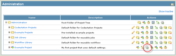

  1. To create a job, click the Add Job icon of your project. Note that a job can only be created after the project's originating workflow has been created. If you get a message saying, "You must create an originating workflow and configure a source config before creating any jobs," see Create a New Workflow before continuing.
  2. Use the Job Wizard to create your build job. Check Yes and click Select. The Job Wizard will take you through the steps necessary to create a build job.

  1. Go to the Dashboard and select the workflow you want to build.
  2. On the workflow's Main page, Click the Build button.
