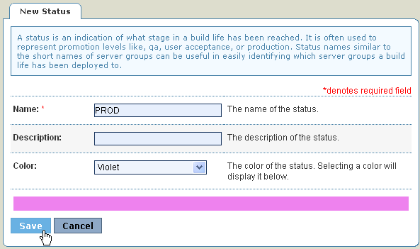

  1. To create a new status, select the Status link from the New Life-Cycle Model main page.
  2. Click the Create New button.
  3. Name, give a description of, and assign a color to the new status. When selecting a color, you can use the up/down keys to quickly scroll through the picker.
  4. Click Save.
  5. Arrange order by using the Move Status Up and/or Move Status Down icons under the Operations menu.

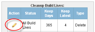

The cleanup of Build Lives is based on the status the Build Life has achieved. For example, set the cleanup to keep all Build Lives a minimum number of days or choose a specific status, such as failure, to expire after a minimum number of days, etc. Once set, the Cleanup Schedule will apply these settings every time it automatically fires. For example, if your cleanup schedule fires once a week, but you set the All Build Lives field to 100 days, when the cleanup schedule fires, only Build Lives that are older than 100 days will be cleaned up. To set the Build Life cleanup policy:
  1. Under the Cleanup Build Lives menu, select the Edit icon for the appropriate status.
  2. Keep Days. Give the minimum number of days to keep all Build Lives that have been assigned this status (leave the field blank to keep all Build Lives).

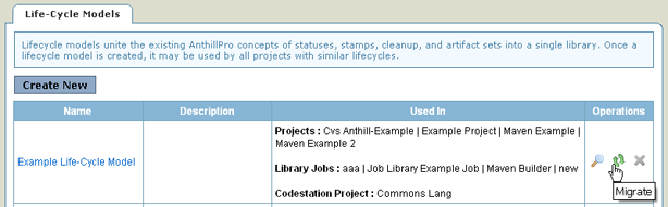

  1. Go to System > Life-Cycle Model under the Project Support menu.
  2. On the Life-Cycle Models page, click the Migrate icon of the Life-Cycle Model you want to migrate.
  3. Migrate To. Select the Life-Cycle Model to migrate to from the drop-down menu and click Migrate.
