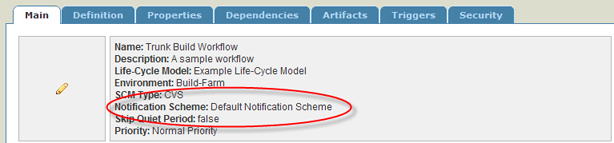

Go to Administration and select the workflow you created in the Create a New Workflow section.
On the workflow Main page, verify that you are using the Default CI Notification Scheme. If so, you are done. If not, go to the next item.
If the workflow is not using the Default CI Notification Scheme, click the Edit icon (the pencil on the left).
Select Default CI Notification Scheme from the Notification Scheme menu then click Save.
The next time a build is completed, committers to this project will receive an e-mail notification.
