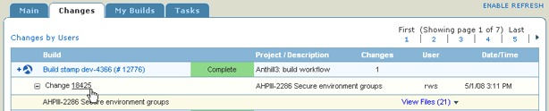

To view revision and file changes via ViewVC:
Go to Dashboard > Changes tab.
Select the change number link and ViewVC will open the revision in a new window.

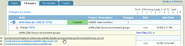

Expand the Change number and select the View Files link. Select an individual change and ViewVC will open a view of the actual change.
Go to Dashboard and select the Changes tab.
