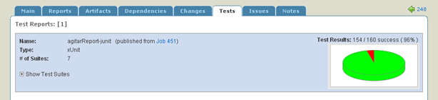

Once the workflow has completed, select the appropriate Build Life and click the Reports tab.
Select a link to view either the agitateReport or the agitateReport_junit.
Selecting the agitateReport link to open the Agitar Dashboard.
Selecting the agitateReport_junit link to open the Agitar/Junit report.
Click the Tests tab for metrics on all the agitateReport_junit reports. Selecting the Show Test Suites link provides detailed information regarding all the Agitar/Junit tests run on the Build Life.

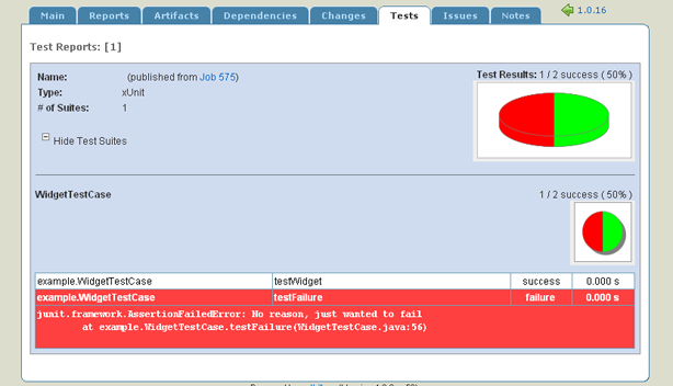

Once a build has completed, go to the new Build Life and select the Reports and Tests tabs for information on the tests run.
Since AnthillPro is aware of CppUnit, the results can be included in build notifications, just like any other piece of information. For example, you may want to automatically take action depending on CppUnit results. Some common examples are to e-mail the team if a failure occurs; e-mail the QA team leader if there are no errors; or e-mail someone if the tests-per-second metric goes below a target amount.

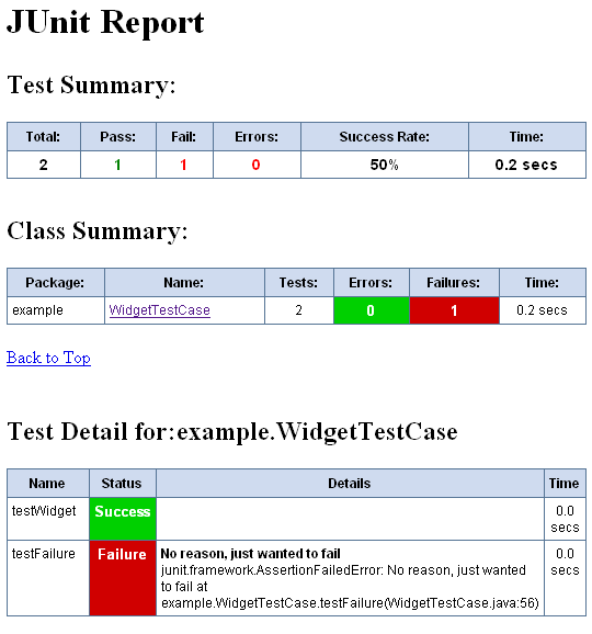

Once the new settings are saved, running the build reveals there is a new report stored in the Tests and Reports tabs of the Build Life (Build Life 127 in the example below). This is a basic report checking the JUnit results. More importantly, the JUnit results are now exposed in a meaningful way.
Since AnthillPro is now aware of the JUnit results, they can be included in build notifications, just like any other piece of information. To edit a notification template, go to the System page and choose the Notification Templates link from the Notification menu. See Managing Notifications.
Lookup the JUnit report(s) and put them in the Velocity context by adding the following to the context script:
WorkflowCase workflow = (WorkflowCase)context.get("workflow");
junitReportArray = JUnitReportHelper.getJUnitReportArray(workflow);
context.put("junitReportArray", junitReportArray); Once the JUnitReports are available to the Velocity template, you can do whatever you like with them. As an example, enter a template that prints out some summary information, as well as a list of every JUnit test that did not pass.
#foreach($junitReport in $junitReportArray)
<h1>JUnit Test Results</h1>
<H2>Test Summary:</H2>
<div class="data-table-container">
<table class="data-table" cellpadding="4" cellspacing="1" width="100%">
<tr class="data-table-head">
<th>Total:</th>
<th>Pass:</th>
<th>Fail:</th>
<th>Errors:</th>
<th>Success Rate:</th>
<th>Time:</th>
</tr>
<tr bgcolor="#ffffff">
<td align="center" style="font-weight: bold;font-size: 14px;">
$junitReport.testSummary.tests
</td>
<td align="center" style="color: green;font-weight: bold;font-size:
14px;">
$junitReport.testSummary.passingTests
</td>
<td align="center" style="color: red;font-weight: bold;font-size:
14px;">
$junitReport.testSummary.failures
</td>
14px;">
$junitReport.testSummary.errors</B>
</td>
$fn.formatNumber($junitReport.testSummary.successPercentage ,
</td>
$fn.formatNumber($fn.duration($junitReport.testSummary.time),
'##0.0’) secs
</td>
</tr>
</table>
</div>
#foreach( $suite in $junitReport.suiteResultArray)
#if( $suite.passingTestCount < $suite.tests )
<h3> Failed tests in $suite.name </h3>
#foreach( $case in $suite.testCaseResults )
#if( $case.errorCount > 0 )
#foreach( $error in $case.errorArray )
<td valign="top" style="color: red;font-weight: bold;" width="275">
$case.name<br>
(error)</td>
<td valign="top" style="color: red;"><B>$error.type</b><br>
$error.content
</td>
</tr>
#end
#end
#if( $case.failureCount > 0 )
#foreach( $error in $case.failureArray )
$case.name<br>
(failure)</td>
<b>$error.message</b><br/> $error.content
</td>
</tr>
#end
#end
#end
</table>
</div>
#end
#end
#endIncluded in an HTML-friendly e-mail template, this will produce a nice little report. The example project has one failing test and one passing test. That produces the following in an e-mail.

Once the workflow is complete, go to the Build Life page and select the Reports tab.
In addition to publishing the test results on the Build Life page, AnthillPro also stores the results in its data warehouse, thus enabling you to compare your test runs over time (trending).
Select the Publish_QTP_Results link to view the QuickTest Pro report.

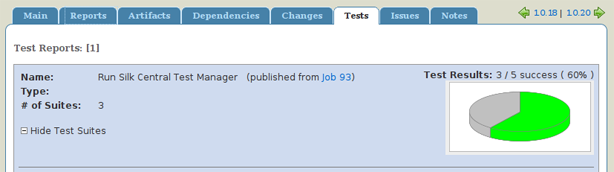

Run Tests. Runs a test suite using Borland SilkCentral Test Manager. May be used as part of an originating and/or non-originating workflow.
This tutorial will follow a simple project configuration that first uses the SilkCentral Run Tests step as part of an originating workflow (i.e., a Continuous Integration build job) to run Unit tests, and as a secondary workflow to run functional tests, etc. The example in this tutorial uses Subversion, but the basic configuration is similar for any repository type. Your jobs will vary, but the SilkCentral integration is added as a job step similar to what is described below.

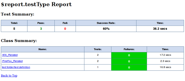

Select the test from the Publish Reports menu. A detail of each test run (not shown) is also available.
Once the workflow is complete, go to the Build Life page and select the Tests tab.

Once the build is run, go to the new Build Life and select the Test tab. There, you can investigate the findings.
