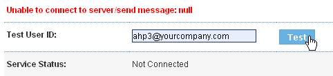

AnthillPro can be used to send instant messages using Google Talk, Jabber, or MSN IM. For example, AnthillPro may be configured to send an instant message to a group of committing developers when a build fails, etc. See Managing Notifications.
The Google Talk and Jabber integrations are configured by following the XMPP IM link under the Notification menu on the System page. The integration can be disabled any time by clicking the Disable button. Using the Test User ID and Service Status fields allow you to troubleshoot the connection.
AnthillPro requires an external Google Talk server to route messages. Any steps within AnthillPro relying on Google Talk (XMPP) will not work until this configuration is complete.
You must have administrative permissions to the System page. See Manage Security.
AnthillPro notification and security systems must be configured in order for the integration to work. See Managing Notifications.
AnthillPro is added as a Google Talk user.
Go to System > XMPP IM from the Notification menu.
On the XMPP page, click Enable then click Edit.
Configure the integration:
Name. Give the name of this XMPP configuration.
Server Host. Provide the XMPP server host name, typically an IP or host name that can be resolved from the server running AnthillPro. For example: jabber.org or talk.google.com.
Server Port. Give the XMPP server port. If using multiple ports, separate then with commas (e.g., 5222, 5223, 5224).
Domain. Provide the XMPP user domain.
Username. Give the user name (e.g., anthill3).
Password. Give the password.
Click Set then Done.
To begin sending instant messages, click Enable. (If Disable is visible, the instant message integration is currently active.)

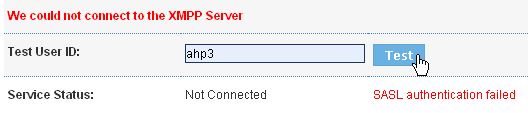

AnthillPro requires an external Jabber server to route messages. Any steps within AnthillPro relying on Jabber (XMPP) will not work until this configuration is complete.
AnthillPro is added as a valid Jabber user.

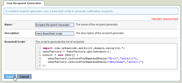

Scripted. Use a BeanShell script to generate notification recipients (see Recipient Generator Scripts). Proceed to Item Seven.

Configure the Scripted Recipient Generator.
Name the Generator.
Description. Provide a description.
BeanShell script. Input the script that generates the list of recipients. See Recipient Generator Scripts.
Click Save then Done.

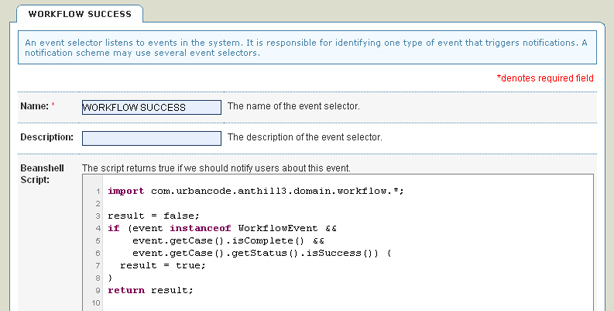

In order to determine which events should trigger a notification, AnthillPro maintains a set of event selectors. These are scripts that examine events generated by workflows and workflow requests, and return true if a notification should occur and false otherwise. For most circumstances, users will not need to write new event selectors. The product ships with a good set of default scripts:
Workflow Success. Triggers notifications when the workflow completed successfully.
Workflow Fails. Triggers notifications when the workflow completes without success.
Workflow Success or Failure. Triggers when a workflow completes regardless of status.
Build Request Failed. Triggers when a workflow does not occur due to an error in the build request. See Scripting.
Go to System > Event Selectors under the Notification menu.
Click the Create Event Selector button on the main page.
Name the new Event Selector, give it a description (optional), provide a script, and click Save. See Event Selector (Scripting).

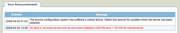

Once an announcement is created by an AnthillPro administrator, the message will automatically appear at the top of the AnthillPro UI for every user. Users can hide any announcement by following the hide link within any announcement. Selecting the announcements link in the upper right-hand corner of the AnthillPro UI allows users to view all active messages, including those previously hidden.
Go to System > Announcements under the Server menu.
On the Announcements page, Click the New button.
Configure the message:
Message. Enter the message. Up to 4,000 characters maximum.
Priority. Select the priority (default is normal) from the drop-down menu.
Low. Displays message in gray.
Normal. Displays message in black.
High. Displays message in red.
On the Announcements page, select the Edit icon of the announcement to be edited.
Modify the text in the Message filed and/or change the Priority. When done, click Save then Done.
If an announcement has been hidden by a user, changes are only viewable on the Your Announcements page. See Viewing Announcements.
To delete an announcement, click the Delete icon and then OK.
Once an announcement has been sent, it appears at the top of every user's AnthillPro UI. If an announcement has been hidden, it can be viewed on the Your Announcements page.
Hide any announcement by following the hide link within any announcement. If the hidden announcement is edited by the sender, it will not automatically reappear.
Select the announcements link in the upper right-hand corner of the AnthillPro UI to view all active announcements on the Your Announcements page.
