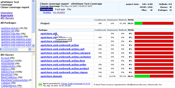

Once the workflow has completed, select the appropriate Build Life and click the Reports tab.
Select the Clover link to view the Clover coverage report for this build.

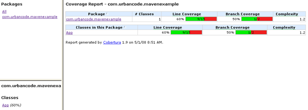

Select the Cobertura link to view the Cobertura coverage report for this build.
