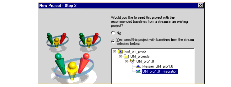

In Step 2 of the wizard, select Yes to indicate that the project begins from the baselines in an existing project. Then navigate to the project that contains those baselines. Figure 27 shows that the new project is based on the baselines in the OM_proj1.0_Integration stream.
Figure 27 Step 2 of New Project Wizard
Step 3 lists the latest baselines in the project that you select in Step 2. If you created a composite baseline to capture the final approved baselines in the existing project, select it. You can add baselines from components that are not part of the existing project by clicking Add to open the Add Baseline dialog box. Similarly, you can remove a baseline by selecting it and clicking Remove.
