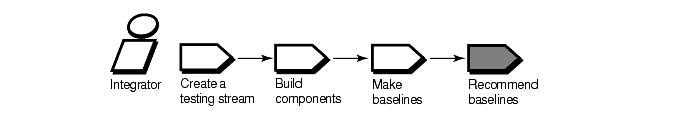

As work on your project progresses and the quality and stability of the components improve, change the baseline's promotion level attribute to reflect a level of testing that the baseline has passed, and recommend baselines that have passed extensive testing.
To change a baseline's promotion level:
In the Project Explorer, right-click the stream to display its shortcut menu. Click Properties to open the stream's Properties dialog box.
Click the Baselines tab.
In the Components list, select the component that contains the baseline you want to promote. In the Baselines list, select the baseline. Click Properties. The baseline's Properties dialog box opens.
Click the arrow in the Promotion Level list to display all available promotion levels. Select the new promotion level.
To recommend a baseline or set of baselines:
In the Project Explorer, select the stream. Click Tools > Recommend Baselines.
In the Recommended Baselines dialog box, you can filter the list of baselines displayed by selecting a promotion level and clicking Set List. The dialog box then displays only baselines at or above the selected promotion level.
To remove a baseline from the list, select it and click Remove. To add a baseline, click Add and select the baseline in the Add Baseline dialog box.
To recommend a different baseline of a component, select the baseline and click Change. In the Change Baseline dialog box, select the baseline that you want to recommend. To select a baseline in another stream, such as a testing stream, click Change and navigate to the stream in the Choose Stream dialog box.
When you finalize your list of recommended baselines, click OK in the Recommended Baselines dialog box.
