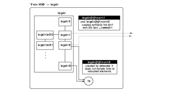

Config specs that look for relocated elements on a branch other than that on which the relocate operation was performed. Figure 27 shows the source VOB from Figure 22, expanded to include a second branch on the directory that contained the relocated elements. Note that relocate adds symbolic links only to versions on the branch used to select the element at relocate time. (See the key in Figure 21 here.)
Figure 27 Source VOB with Multiple Branches on Parent Directory

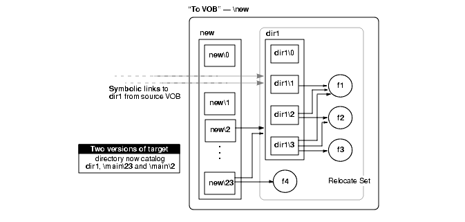

In Figure 23 here, relocate checks in a new version of the destination directory, and only that version catalogs the relocated elements. Now, consider this scenario:
You have a view, alh_port, that selects a previous version of the target directory (\new@@\main\2, for example).
You want the alh_port view to be able to see the newly relocated dir1 element at its new home, \new\dir1, rather than at its old location, \bigdir\dir1.
In a case like this, you can manually update previous versions of relocate's destination directory to catalog relocated elements. For example, to add dir1 to directory version \new@@\main\2:
Log on as the privileged user.
Create the VOB symbolic link. The following command requires special privileges because it modifies a directory version's contents without checking it out or changing its event history.
cd \new (and your working view must select some version of dir1)
cleartool ln -slink -nco dir1 \new@@\main\2\dir1
Modify non-checkedout directory version "\new@@\main\2"? [no] yes
Link created: "\new@@\main\2\dir1"
Figure 28 shows the effect of the cleartool ln -nco command. (See the key in Figure 21 here.)
Figure 28 Destination VOB After Modifying Old Version of Destination Directory
In Figure 22 here and Figure 25 here, the latest version of a relocated element's parent directory does not catalog that relocated element. In some circumstances, you may want to add such cataloging manually, in the form of symbolic links. For example, the following command sequence updates the from-directory version bigdir@@\main\3 (Figure 22) to see relocated directory dir1 at its new location:
cd \new
cleartool ln -slink -nco dir1 \bigdir@@\main\3\dir1
Modify non-checkedout directory version "\bigdir@@\main\3"? [no] yes
Link created: "\bigdir@@\main\3\dir1"
