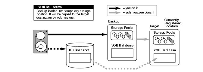

Given a complete and consistent VOB storage backup, vob_restore can accommodate a variety of restore scenarios. You can use vob_restore with or without a VOB snapshot. Any valid VOB backup (as defined in section 10.2 and 10.3) will work. vob_restore handles all of the following subtasks:
Stops and restarts ClearCase
Updates the ClearCase VOB registry
Merges the VOB database snapshot and VOB storage directory
Copies the temporary storage directory to the target location
Runs checkvob to resynchronize the VOB database and storage pools

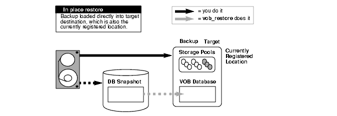

The VOB is being restored to its current location (\\io\vobstore\vob_src.vbs). This is the in-place scenario, which is the most common.
The data currently in the VOB is invalid, so there is no need to maintain read-only access to the VOB during the restore operation.
A database snapshot for this VOB, \\io\e\vob_snaps\src, is used.
The administrator is logged on as Administrator on the VOB host, io.
As is recommended, the restored data is not retrieved from backup media before running vob_restore.

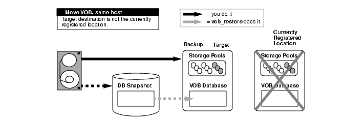

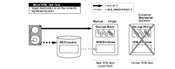

vob_restore prompts for a target destination for the reassembled VOB storage directory.
Specify the full path for target storage directory to contain the VOB or
VOB replica. The default is the currently registered local path:
Type a full pathname, "help", or "quit": <RETURN>
Pressing RETURN restores the VOB to its current, registered location. Supplying a different pathname moves the VOB. The pathname supplied here must be on the local host.

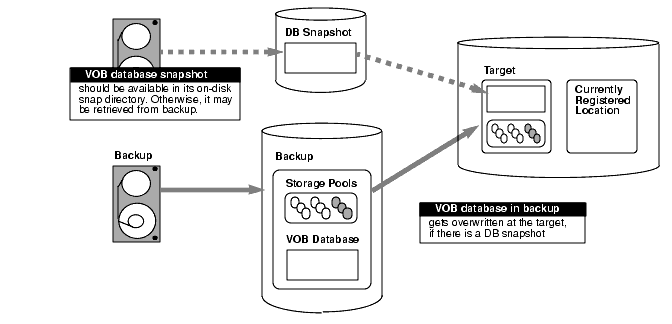

vob_restore prompts for the location of the VOB database snapshot, if any. If you are not using a semi-live backup strategy for this VOB, press RETURN.
If a merge of a snapped database with this retrieved backup data is
desired, please specify the full pathname of the snapped database.
(Full path, help, quit): \\io\e\vob_snaps\src

At this point, vob_restore has the information it needs to determine the restore scenario. See also vob_restore: Restoration Scenarios.
The information you supplied, and the state of the registry at that time, resulted in the following initial restoration parameters. If this invocation is a restart, the current registry state may be different.
o The vob is currently registered.
o The restored vob will be placed in its previously registered location
on its previously registered host
io
o The restoration will be done in place.
o The database will be copied from the snapshot directory
If you wish, you may quit for now and restart the script at a later time.
Do you want to proceed?
Valid responses are (yes,quit)
The default is yes: yes<RETURN>

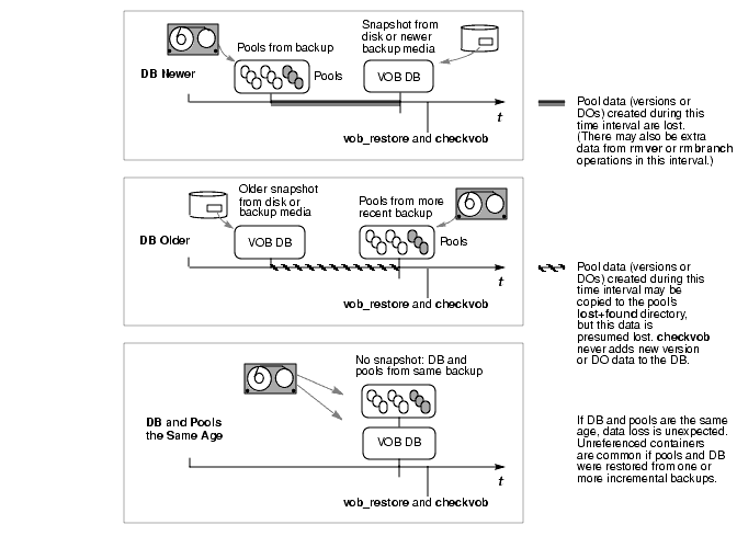

Confirm that you have supplied a VOB database snapshot. vob_restore merges it with the retrieved VOB storage backup, overwriting any VOB database retrieved with the storage directory:
The restored storage area contains a copy of a directory being restored
from the snapshot area.
\\io\vobstore\vob_src.vbs\db
Is it ok to remove this copy?
Valid responses are (yes,quit,help)

If you supplied a database snapshot when prompted for one, you must run checkvob to resynchronize the VOB database and storage pools. We recommend that you run checkvob whenever you restore a VOB, because it may expose problems in the restored VOB.
NOTE: vob_restore replaces the VOB lock with one that permits access by the checkvob process, and relocks the VOB against all users when checkvob exits. Make sure that the user ID under which vob_restore or checkvob runs does not modify the VOB in any way while checkvob is running. Failure to do so will irreversibly break a replicated VOB.
Do you want to have checkvob examine the vob for possible problems?

As shown in Figure 8, vob_restore's task is to merge the backup and the snapshot (if there is one) at the target, and to correctly re-register the target, which may be at a location other than the VOB's currently registered location.
vob_restore uses your input to describe the restore scenario. For example, Figure 9 shows the scenario from the sample restore session in the previous section.

This scenario is illustrated in Figure 10
Formula. backup = target = currently-registered-location
Advice. Use this scenario whenever practical.
Figure 10 vob_restore: In Place
In this scenario, the VOB is still active for read-only access, so the backup must be loaded into a temporary storage location. (See Figure 11.)
Formula. (backup different from target) and (target = currently-registered-location)
Advice. Do not combine this scenario with a move VOB scenario. Keep the VOB at its currently registered location.
Figure 11 vob_restore: VOB Is Active
In this scenario, the backup is restored to a different location on the same host. (See Figure 12.)
Formula. target different from currently-registered-location
Advice. Load the backup directly into the target destination.
Figure 12 vob_restore: Move VOB on Same Host
When moving a VOB as part of a vob_restore operation, the target host must have the same architecture (hardware and operating system). (See Figure 13.)
NOTE: You must run vob_restore on the target host.
Figure 13 vob_restore: Move VOB to New Host

Any restore scenario that includes a VOB database snapshot introduces an additional complication: the VOB database and VOB storage pools have different reference times; that is, one is newer than the other. This skew must be resolved in the restored VOB. Run checkvob to resolve it. Figure 14 illustrates the problem and summarizes what checkvob does when the a VOB database is newer or older than the VOB's storage pools (the backup) at restore time.
Figure 14 VOB Database or Storage Pool Skew Associated with VOB Snapshots
VOB snapshots have minimal impact on the your work at restore time. When prompted by vob_restore, you need only supply the correct snapshot directory. However, the checkvob portion of a vob_restore operation is critical. You must be prepared to respond intelligently to checkvob prompts and to understand the implications of any errors reported in its output. Typically, checkvob finds and repairs numerous small problems, but it reports version and DO data loss for the interval between storage pool and VOB database reference times.
For more information, see the checkvob reference page and Chapter 14, Using checkvob.
