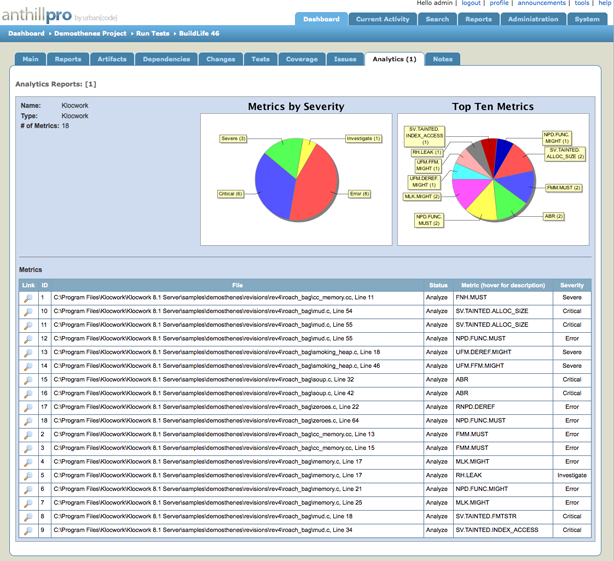

Once the job with the Checkstyle step has been configured, run a build. The completed build will publish the report on the Dashboard. To view the results:
Go to the Dashboard, and select the completed Build Life.
On the Build Life page, select the Analytics tab.
On the Analytics tab, you can explore the number and type of findings, track changes between builds, and find out which defects are new. From the page, it is also possible to reference the change log for more information.

Once the job with the CodeSonar step has been configured, run a build. The build will kick off CodeSonar, run the tests, and publish the reports on the Dashboard. To view the results:

The Klocwork Insight integration is added to AnthillPro jobs as a step. The Job with the Klocwork Insight step must be executed as part of a workflow. The Klocwork Insight step can be configured to build, analyze and upload the results of any project (C, C++, Java Ant, MS Visual Studio) already configured in Klocwork.
This section will assume that an originating workflow has already been configured, and will cover the process of adding the Klocwork Insight build job to the appropriate workflow.
Once the job has been created, you will need to ensure that the job runs on the machine that has both Klocwork and the AnthillPro Agent (which will run the job) installed on it. This is done by selecting the appropriate agent when configuring the workflow definition. See Complete Build Process Configuration and Agent Management for information on agent selection.
Complete workflow configuration is beyond the scope of this entry. The topics covered in detail below are specific to using the Klocwork Insight integration.
Typically, the Klocwork Insight step is included after the Populate Workspace, Changelog, Stamp, Dependency, Build, Publish Changelog, and Artifact Delivery steps of the Build job. However, each job will vary, and it is possible to set up AnthillPro to run Klocwork Insight as part of a secondary workflow.
Go to Administration, select the appropriate project, and click the Add Job icon.
On the New Job Configuration page, choose No (do not use the Job Wizard). Click Select.
Follow the steps for creating a build job.
When configuring the workflow definition, make sure that the job runs on the machine that has both Klocwork Insight and the AnthillPro Agent installed. See Complete Build Process Configuration and Agent Management for information on agent selection.
Run Klocwork Step. Select the Insert After icon of the step that will run before the Run Klocwork Insight step.
Expand the Source Analytics folder. Then expand the Klocwork Insight folder.
Select Run Klocwork and click Select.
Configure step:
Name the step. This name will be used by the AnthillPro system.
Description. Give an optional description of this step.
Working Directory Offset (optional). Give the working directory to use when executing this command. This is relative to current working directory. To use the current directory, leave this field blank.
Report Name. Give the name of the Klocwork Insight report. The report name is used to publish results to the AnthillPro Dashboard. See View Klocwork Insight Results and Trending.
Project Name. Give the name of the project as set in Klocwork Insight.
Note that in order for the integration to work, the project name must start with a letter (i.e., a, b, c, etc.). In addition, only digits (0 through 9), Latin letters (A through Z, a through z) and the underscore character are allowed in a project name. A project name must not be no more than 54 characters.
Build. Perform the build. This requires the Build Options to be entered below.
Build Type. Select the type of project that is being built and analyzed.
Build Options. If the build field is checked above, you must give the build options that will be passed to the sourceanalyzer when the build runs. Each argument should be started on a new line.
Build Specification. Give the path to the Klocwork build specification file, if different than the default kwinject.out location.
Run. By default, the integration will perform the analysis. If this box is checked, you must give the Build Specification above.
Include Description (optional). Check the box to include a description with each Klocwork Insight finding. Note that if this option is selected, it may consume large amounts of space in the database. If you experience problems when including descriptions, change this setting back to the default.
Upload. By default, AnthillPro will perform the upload to the Fortify server. To perform an upload, you will need give the Project and Version below, as well as give the Scan File above.
Build Name. Give the name
of the build to load the results as. Typically, the following
AnthillPro stamp value is most often used:
${bsh:StampLookup.getLatestStampValue()}
Note that only digits (0 through 9), Latin letters (A through Z, a through z) and the underscore character are allowed in a project or build name.
In addition, the AnthillPro Build Life ID can be used for
the build name:
${bsh:BuildLifeLookup.getCurrent().getId()}
. As
well as the AnthillPro Stamp Value:
Klocwork. Select the correct Klocwork configuration. AnthillPro supports multiple configurations as part of its Klocwork integration. For example, it is possible to configure two servers that run different test suites, etc. The names appearing in this drop-down menu were set during the configuration process. If you don't see the correct configuration, see Configure Klocwork Insight to add the appropriate configuration before continuing.

Once the job with the Klocwork step has been configured, run a build. The build will kick off Klocwork, run the tests, and publish the reports on the Dashboard. To view the results:
