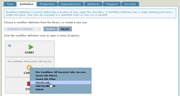

Configure Job Iterations:
Go to Administration and select the workflow that contains the job to be iterated.
On the workflow page, select the Definition tab.
Click the job to be iterated and select Iterate Job from the menu.
