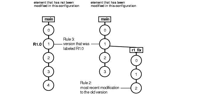

This config spec allows developers to modify a configuration defined with version labels:
(1) (2) (3) |
element * CHECKEDOUT element * ...\r1_fix\LATEST element * R1.0 -mkbranch r1_fix |
Elements can be checked out (Rule 1).
The checkout command creates a branch named r1_fix at the initially selected version (the auto-make-branch clause in Rule 3).
A key aspect of this scheme is that the same branch name, r1_fix, is used in every modified element. The only administrative overhead is the creation of a single branch type, r1_fix, with the mkbrtype command.
This config spec is efficient: two rules (Rules 2 and 3) configure the appropriate versions of all elements:
For elements that have been modified, this version is the most recent on the r1_fix subbranch (Rule 2).
For elements that have not been modified, this version is the one labeled R1.0 (Rule 3).
Figure 39 illustrates these elements. The r1_fix branch is a subbranch of the main branch. But Rule 2 handles the more general case, too: the ... wildcard allows the r1_fix branch to occur anywhere in any element's version tree, and at different locations in the version trees of different elements.
Figure 39 Making a Change to an Old Version
The config spec in View to Modify an Old Configuration omits the standard \main\LATEST rule. This rule is not useful for work with VOBs in which the version label R1.0 does not exist. In addition, it is not useful in situations where new elements are created. If your development policy is to not create new elements during maintenance of an old configuration, the absence of a \main\LATEST rule is appropriate.

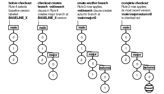

This config spec implements and enforces consistent multiple-level branching.
(1) (2) (3) (4) (5) |
element * CHECKEDOUT element * ...\major\autumn\LATEST element * ...\major\LATEST -mkbranch autumn element * BASELINE_X -mkbranch major element * \main\LATEST -mkbranch major |
A view configured with this config spec is appropriate in the following situation:
All changes from the baseline designated by the BASELINE_X version label must be made on a branch named major.
Moreover, you are working on a special project, whose changes are to be made on a subbranch of major, named autumn.
Figure 40 shows what happens in such a view when you check out an element that has not been modified since the baseline.
Figure 40 Multiple-Level Auto-Make-Branch
For more on multiple-level branching, see the config_spec and checkout reference pages.
