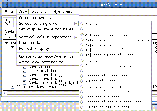

To sort the coverage data, select
View > Select sorting order, then select the order you want.

Using viewer display features
Selecting the sorting order
Shortening
method names in the viewer
