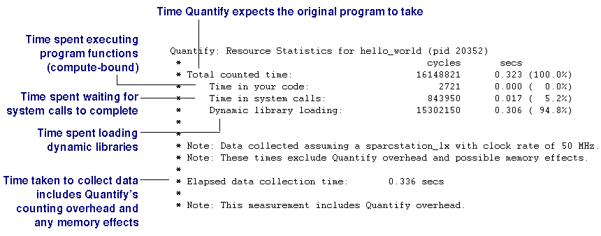

After your instrumented program exits, Quantify prints a program performance summary showing at a glance how the original non-Quantify'd program can be expected to perform.
