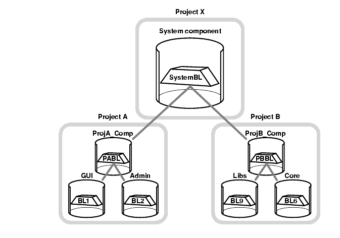

For example, in Figure 13, Project A uses a composite baseline, PABL, to select baselines in the GUI and Admin components. Project B also uses a composite baseline, PBBL. Baselines that are selected by a composite baseline are referred to as members.
After you create a composite baseline to represent the project baseline, the next time you invoke the make baseline operation on the component that contains the project baseline, UCM performs the operation recursively. If a component that contributes to the composite baseline has changed since its latest baseline, UCM creates a new baseline in that component. For example, assume that developers made changes to files in the GUI component after the integrator created the BL1 baseline. The next time the integrator makes a new project baseline, UCM creates a new baseline in the GUI component that incorporates the changed files, and the new project baseline selects the new GUI baseline.
A composite baseline can select other composite baselines. For example, if your system is so large that it consists of multiple projects, you may want to use a composite baseline to represent the system baseline. In Figure 13, SystemBL is a composite baseline that selects the PABL and PBBL baselines of Project A and Project B, respectively.
In addition to using a composite baseline to represent the project, you can use multiple composite baselines within the same project. When working with multiple composite baselines, you can encounter situations where two composite baselines select different baselines of the same component. When this happens, you need to resolve the conflict by choosing one of the member baselines. To avoid these conflicts, we recommend that you choose a simple baseline design, rather than one that uses a complex hierarchy of composite baselines. See Resolving Baseline Conflicts for details about baseline conflicts.
Like all baselines, a composite baseline must belong to a component. However, that component does not need to contain any of its own elements. For example, in Figure 13, the System_Comp, ProjA_Comp, and ProjB_Comp components consist only of their composite baselines. When you create a component to be used solely for housing a composite baseline, you can specify an option that directs UCM to make the component without creating a root directory in a VOB. Such a component can never contain its own elements.
Figure 13 Using a System-Level Composite Baseline
