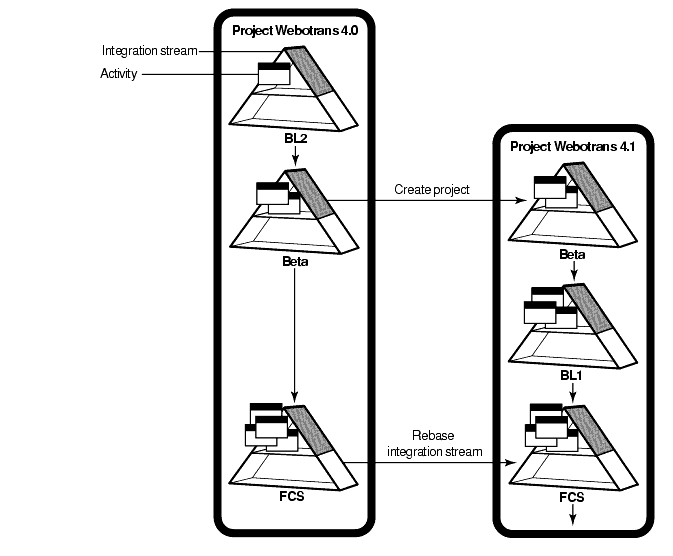

Given the tight software development schedules that most organizations operate within, it is common practice to begin development of the next release of a project before work on the current release is completed. The next release may add new features, or it may involve porting the current release to a different platform.
Figure 37 illustrates the flow of a current project, Webotrans 4.0, and a follow-on project, Webotrans 4.1.
Figure 37 Managing a Follow-on Release
The project manager for the follow-on project created the Webotrans 4.1 project based on the Beta baselines of the components used in the Webotrans 4.0 project. Developers on both project teams then continued to make changes, and the 4.0 and 4.1 integrators continued to create new baselines that incorporate those changes.
When the 4.0 team completed its work, the integrator created the final baselines, named FCS. The 4.1 project manager then rebased the 4.1 integration stream to the FCS baselines.

Note that you can rebase your project's integration stream only if the baseline to which you are rebasing is a successor of your integration stream's current foundation baseline. In the above example, the FCS baseline is a successor to the Beta baseline, which is the current foundation baseline for the Webotrans 4.1 integration stream.
