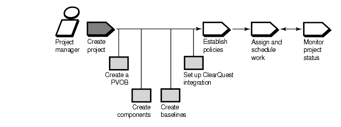

To create and set up a project, you must perform the following tasks:
Create a repository for storing project information
Create components that contain the set of files the developers work on
Create baselines that identify the versions of files with which the developers start their work
To use UCM with Rational ClearQuest, you must perform additional setup steps.

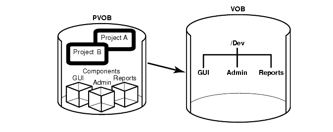

ClearCase stores file elements, directory elements, derived objects, and metadata in a repository called a versioned object base (VOB). In UCM, each project must have a project VOB (PVOB). A PVOB is a special kind of VOB that stores UCM objects, such as projects, activities, and change sets. A PVOB must exist before you can create a project. Check with your site's ClearCase administrator to see whether a PVOB has already been created. For details on creating a PVOB, see Creating the Project VOB.
As the number of files and directories in your system grows, you need a way to reduce the complexity of managing them. Components are the UCM mechanism for simplifying the organization of your files and directories. The elements that you group into a component typically implement a reusable piece of your system architecture. By organizing related files and directories into components, you can view your system as a small number of identifiable components, rather than as one large set of directories and files.
The directory and file elements of a component reside physically in a VOB. The component object resides in a PVOB. Within a component, you organize directory and file elements into a directory tree. In Figure 3, the directory trees for the GUI, Admin, and Reports components appear directly under the VOB's root directory. You can convert existing VOBs or directory trees within VOBs into components, or you can create a component from scratch. For details on creating a component from scratch, see Creating Components for Storing Elements. For details on converting a VOB into a component, see Making a VOB into a Component.
Figure 3 VOB Containing Multiple Components

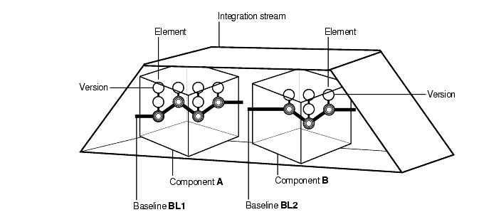

After you create project components or select existing components, you must identify and recommend the baseline or baselines that serve as the starting point for the team's developers. A baseline identifies one version of every element visible in a component. Figure 4 shows baselines named BL1 and BL2 that identify versions in component A and component B, respectively.
When developers join the project, they populate their work areas with the versions of directory and file elements represented by the project's recommended baselines. Alternatively, developers can join the project at a feature-specific development stream level, in which case they populate their work areas with the development stream's recommended baselines. This practice ensures that all members of the project team start with the same set of files.

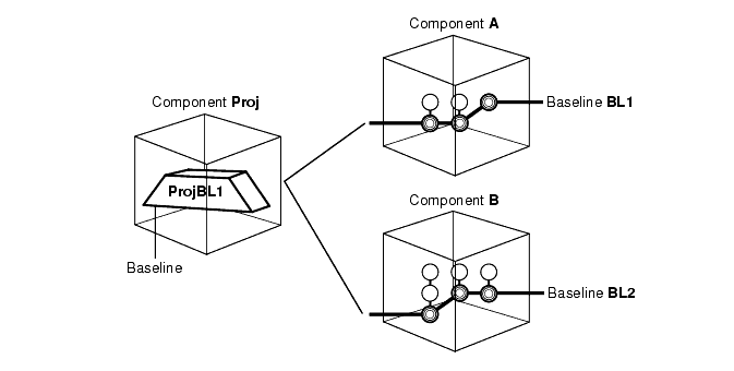

If your project team works on multiple components, you may want to use a composite baseline. A composite baseline selects baselines in other components. In Figure 5, the ProjBL1 composite baseline selects baselines BL1 and BL2 of components A and B, respectively. The Proj component does not contain any elements of its own. It contains only the composite baseline that selects the recommended baselines of the project's components. By using a composite baseline in this manner, you can identify one baseline to represent the entire project.
