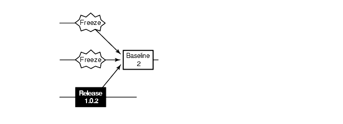

The MIN team is ready to freeze for Baseline 2, and the MAJ team will be soon (Figure 55). Baseline 2 will integrate all three development efforts, thus requiring two sets of merges:
Bug fix changes from the most recent patch release (versions labeled R1.0.2) must be merged to the main branch.
New features must be merged from the major branch to the main branch. (This is the opposite direction from the merges described in Merging Ongoing Development Work.)
ClearCase supports merges from more than two directions, so both the bug fixes and the new features can be merged to the main branch at the same time. In general, though, it is easier to verify the results of two-way merges.

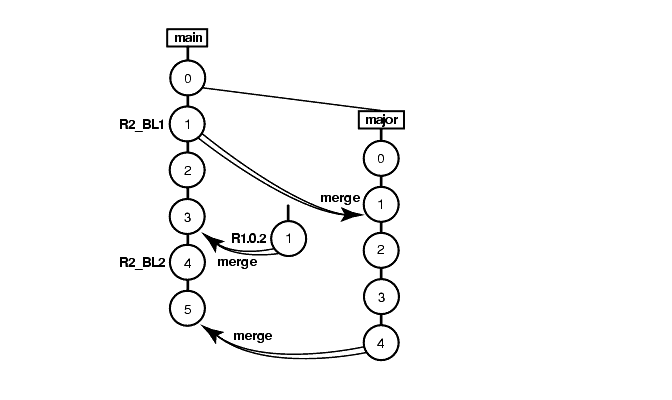

After checkin, the version tree of a typical merged element appears as in Figure 56.
Figure 56 Element Structure After the Pre-Baseline-2 Merge
After all data has been merged to the main branch, development on the major branch will stop. The project manager enforces this policy by making the major branch obsolete:
