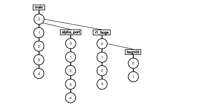

Base ClearCase uses branches to enable parallel development. A branch is an object that specifies a linear sequence of versions of an element. Every element has one main branch, which represents the principal line of development, and may have multiple subbranches, each of which represents a separate line of development. For example, a project team may use the main branch for new development work while using a subbranch simultaneously for fixing a bug.
Subbranches can have subbranches. For example, a project team may designate a subbranch for porting a product to a different platform. The team may then decide to create a bug-fixing subbranch off that porting subbranch. Base ClearCase allows you to create complex branch hierarchies. Figure 1 illustrates a multilevel branch hierarchy. As a project manager in such an environment, you need to ensure that developers are working on the correct branches. Developers work in views. A view is a work area for developers to create versions of elements. Each view includes a config spec, which is a set of rules that determines which versions of elements the view selects.
Figure 1 Branching Hierarchy in Base ClearCase
As project manager, you tell developers which rules to include in their config specs so that their views access the appropriate set of versions.
