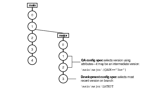

This scheme allows the QA team to monitor the progress of the rest of the group. The development config spec always selects the most recent version on the major branch, but the QA config spec may select an intermediate version (Figure 41).
Figure 41 Development Config Spec vs. QA Config Spec

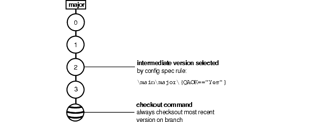

It may seem desirable to use attributes, or other kinds of metadata, in addition to (or instead of) branches to control version selection in a development view. But such schemes introduce complications. Suppose that the config spec above selects version \main\major\2 of element ...\src\cmd.c (Figure 42).
Figure 42 Checking Out a Branch of an Element
Performing a checkout in this view checks out version \main\major\3, not version \main\major\2:
cleartool: Warning: Version checked out is different from version previously selected by view.
Checked out "cmd.c" from version "\main\major\3".
This behavior reflects the ClearCase restriction that new versions can be created only at the end of a branch. Although such operations are possible, they are potentially confusing to other team members. And in this situation, it is almost certainly not what the developer who checks out the element wants to happen.
