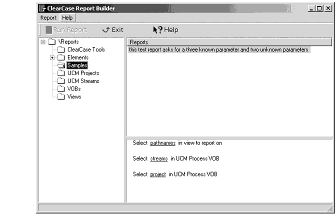

If you do not run the testing script before using your report in Report Builder and a parsing error occurs in processing the interface specification, the new report does not appear in the list of reports in the reports pane. There is no feedback; you see the report desciption in the reports pane or you see nothing. If you don't see a description, the parsing error is serious. If you do see a description, the interface specification is somewhat correct, but you may still be using an invalid parameter, referencing a nonexistent right-click routine, or sending output in the wrong order to STDOUT.
The Report Builder does not check for valid parameters. For example, consider the interface specification for a new report procedure, my_custom_report.prl, with the following interface specification:
description : "This test report asks for a three known parameters and two unknown parameters"
parameters : LOOKIN UNKNOWN_1 STREAMS FOO PROJECT
rightclick :
fields : "field 1"(string)
The second and fourth parameters of this interface specification are invalid. At run time, the description for this report appears in the Report Builder reports pane, but the second and fourth parameters are displayed as blank lines in the parameter pane (Figure 64 ).
Figure 64 Report Builder Window with Invalid Parameters
However, the testing script detects these errors because these parameter names are not supplied with ClearCase Reports (see Table 6):
