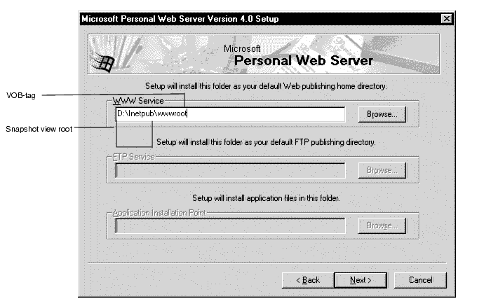

When you install IIS, a screen similar to Figure 37 appears. The default Web alias directory determines the VOB-tag of the Web content VOB that will be created in Step 4. (See Step 4: Run the Web Authoring Integration Configuration Wizard.) You need to choose the VOB-tag you want this Web server to access. By default, this is \wwwroot as shown in Figure 36. If this VOB-tag is already registered in this machine's ClearCase registry or if you want another name (for example, wwwroot_<host>, or a descriptive name, \sales_Webs) you must change the default now. The remainder of this pathname becomes a snapshot view root when the Web Authoring Integration Configuration Wizard is run, as shown in Figure 37.
Figure 37 Setting Up the Root Web in the IIS Installation

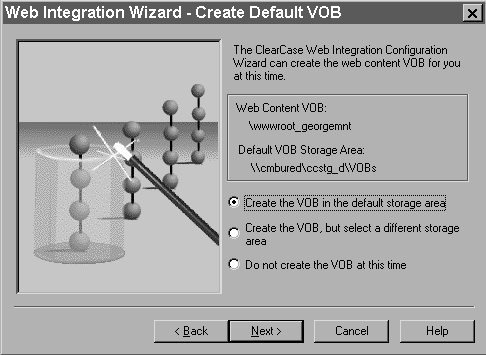

After the Web Authoring Integration Configuration Wizard checks the versions of IIS and server extensions on the Web server, you are prompted to create a content area VOB. You can accept the default VOB storage location, as in Figure 38, or use the wizard to select another VOB storage location.
Figure 38 Setting Up the VOB Storage for the Integration

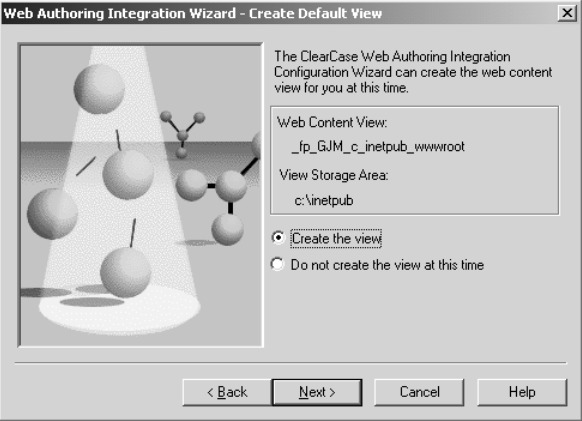

The wizard then prompts you to create a content area view, as in Figure 39.
Figure 39 Setting Up the View Storage for the Integration
