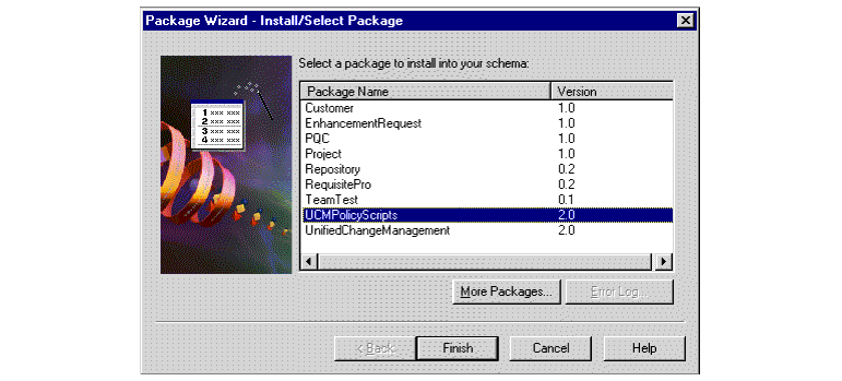

In the ClearQuest Designer, click Package >Package Wizard to start the Package Wizard, as shown in Figure 3.
Add the UCMPolicyScripts package to your schema. If this package is not listed in the first page of the wizard, it has not been installed in your schema repository. To add the package to your schema repository, click More Packages to open the Install Packages dialog box; select the highest version of the package, and click OK. In the wizard, select the package, as shown in Figure 3. Click Next.
Figure 3 Adding the UCMPolicyScripts Package to a Schema
On the second page of the wizard, select your schema, and click Finish. To make the changes to the schema, ClearQuest checks out the schema for you. Check in the schema by clicking File >Check In. ClearQuest creates a new version of the schema.

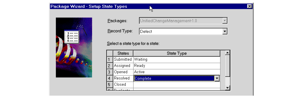

In the fourth page of the wizard, you must assign state types to the states for each record type that you choose to enable. For each state, click in the adjacent state type cell to display the list of available state types, as shown in Figure 4, and select one. To enable another record type, click the arrow in the Record Type list to see the available record types. See Setting State Types for a description of the four state types, and the rules for setting them.
When you are finished, click Finish to check out the schema.

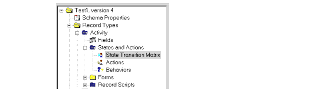

Before you can check in your schema, you must set default actions for the states of each enabled record type. Default actions are state transition actions that ClearQuest takes when a developer begins to work on an activity or delivers an activity. In the ClearQuest Designer workspace, navigate to the record type's state transition matrix, as shown in Figure 5.
Figure 5 Navigating to Record Type's State Transition Matrix
Double-click State Transition Matrix to display the matrix. Right-click the state column heading, and select Properties from its shortcut menu. Click the Default Action tab. Select the default action. See State Transition Default Action Requirements for Record Types for default action requirements. Before you can set default actions, you may need to add some actions to the record type. To do so, double-click Actions to display the Actions grid, and then click Edit >Add Action.
