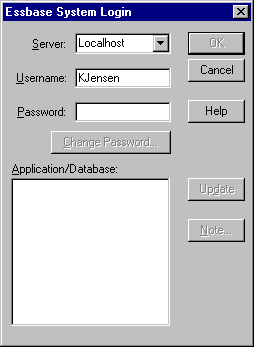

  1. Select Essbase > Connect.
    Essbase displays the Essbase System Login dialog box.
    Figure 82. Essbase System Login Dialog Box
    Note:
    To complete the steps that follow, you need to know the name of the Essbase server, your username, and your password. If you do not have this information, contact the Essbase system administrator.
  2. From the Server list box, select the server that you want to access. (If the server name that you want is not shown in the list, type the name of the server that you want to access.)
  3. To move to the Username text box, press Tab and then, in the Username text box, type your username.
  4. To move to the Password text box, press Tab, and then, in the Password text box, type your password.
    Note:
    You can change your password when you are connected to a server. See "Changing a Password".
  5. To connect to the server, click OK.

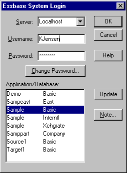

    Essbase displays a list of available application/database pairs in the list box. An Essbase server enables simultaneous access to multiple applications. An application can contain multiple databases. Only the databases to which you have security access display in the list.
    For this tutorial, you use the Sample Basic database. If the Sample Basic database was installed as part of the Essbase installation, it is shown in the list. If Sample Basic is not shown in the Application/Database list, ask the Essbase system administrator to install it.
    Figure 83. Available Application and Database Pairs
  6. In the Application/Database list, double-click Sample Basic, or, from the Application/Database list select Sample Basic and then click OK.
