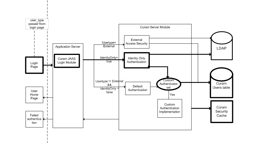

Authentication can be configured to perform identity-only verification, in place of the default verifications listed in Default Verification Process above.
Identity only verification means that the authentication mechanism only ensures that the username for the user logging in exists on the Cúram Users database table. Full authentication must be completed by an alternative mechanism, to be configured in the application server.
An example of an alternative mechanism is an LDAP directory server, which is supported as an authentication mechanism by both the WebSphere® and WebLogic Server application servers. Another alternative is to use a Single Sign-On Solution for authentication, or to implement a custom login module. For custom application server solutions the IBM or Oracle documentation should be consulted.
