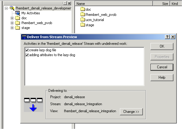

Using the Project Explorer, one way to start the deliver operation is the following:
  1. Right-click the root directory of your development view.
  2. From the shortcut menu, select either Deliver from stream to default or Deliver from stream to alternate target.
  3. The following example shows the Deliver from Stream Preview dialog box listing two activities that are still to be delivered.
    ClearCase found that the two activities created in previous exercises were not delivered.
    All other information, namely the project, the stream, and the view where the activities will be delivered, is correct.
  4. Click OK.

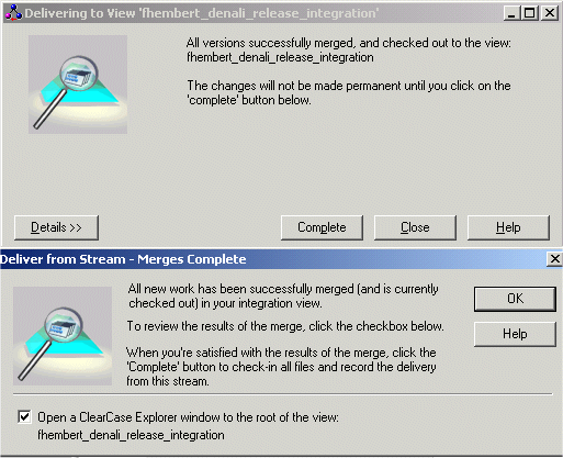

  5. ClearCase starts the deliver operation and displays progress information.
    This point in the deliver process does not indicate the deliver operation is complete. You have reached a point where you can verify if the newly created version of the files will enable you to perform a successful test build before completing the deliver operation. If not, you can now make the necessary corrections.

Phase 5: Completing the Delivery
After you have made sure that the work you deliver is error-free, you are then ready for the final phase, namely to complete the deliver operation.
During this phase, the deliver operation verifies the merges, checks in the changes in the target integration stream, and performs general housekeeping tasks.
