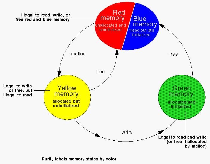

Purify maintains a table to track the status of each byte of memory used by your program. The table contains two bits that represent each byte of memory. The first bit records whether the corresponding byte has been allocated. The second bit records whether the memory has been initialized. Purify uses these two bits to describe four states of memory: red, yellow, green, and blue.
Purify checks each memory operation against the color state of the memory block to determine whether the operation is valid. If the program accesses memory illegally, Purify reports an error.
Red: Purify labels heap memory and stack
memory red initially. This memory is unallocated and uninitialized. Either
it has never been allocated, or it has been allocated and subsequently
freed.
In addition, Purify inserts guard zones around each allocated block
and each statically-allocated data item, in order to detect array bounds
errors. Purify colors these guard zones red, and refers to them as red zones. It is illegal to read, write,
or free red memory because it is not owned by the program.
Yellow: Memory returned by malloc or new is yellow. This memory has been allocated so the program owns it, but it is uninitialized. You can write yellow memory, or free it if it is allocated by malloc, but it is illegal to read it because it is uninitialized. Purify sets stack frames to yellow upon function entry.
Green: When you write to yellow memory, Purify labels it green. This means that the memory is allocated and initialized. It is legal to read or write green memory, or free it if it was allocated by malloc or new. Purify initializes the data and bss sections of memory to green.
Blue: When you free memory after it is initialized and used, Purify labels it blue. This means that the memory is initialized, but is no longer valid for access. It is illegal to read, write or free blue memory.
