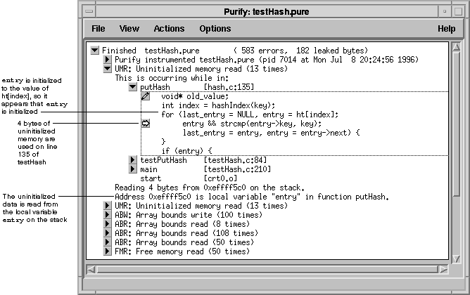

Reading uninitialized memory
When a program attempts to perform an operation using values from uninitialized memory, the results can be unpredictable. The code often appears to work correctly until an unrelated part of the program changes, causing it to malfunction in mysterious ways. Purify calls this type of error an uninitialized memory read (UMR).
A UMR example
Expand the UMR line, then expand the putHash line.
Purify distinguishes between copying uninitialized data and using it in an operation. In this example, the program tests whether entry is non-NULL on line 135. Purify checks this access, and finds that entry contains uninitialized data. Purify reports a UMR error. The error is that ht[index] is not initialized before the copy to entry.
Notice, however, that Purify does not signal an error on line 134 when ht[index] is copied into entry. This is because it is common for correct code to copy uninitialized data, particularly when copying structures containing padding bytes used to align fields of differing sizes. For this reason, Purify does not report uninitialized memory copy (UMC) errors by default.
In this example, the code appears to work correctly when it is tested because the value of ht[index] is expected to be initialized to NULL. Since the memory in ht[index] has not been used, it happens to be NULL even without being initialized. The code is not correct, but appears to run correctly in the test cases. However, if new code is added later the program can produce incorrect results.

Finding the cause of the UMR error
To correct this error, you must determine where ht[index] should have been initialized. By looking at Purify's initial error message, you can see that putHash is called by testPutHash, which is called by main.
  1. Click the Edit button imageedit.gif in the message to open the source file.
  2. Notice that ht is initially allocated in the function makeHashTable in hash.c.
hashtable* makeHashTable()
 hashtable* ht;
 ht = (hashtable*)malloc(HASHTABLE_SIZE*sizeof(hashEntry*));
 return(ht);
The memory that ht points to is never initialized.
