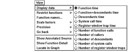

Sorting the function list
To sort the function list based on the various data Quantify collects, select View > Display data.

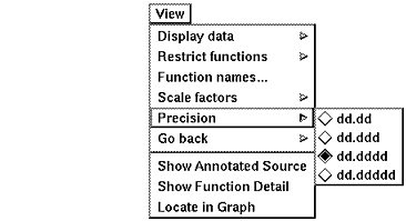

Changing the scale and precision of data
Quantify can display the recorded data in cycles (the number of machine cycles) and in microseconds, milliseconds, or seconds.
To change the scale of data, select View > Scale factors.
To change the precision of data, select View > Precision.

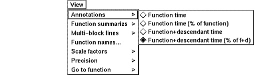

Changing annotations
To change annotations, use the View menu. You can select both function and function+descendants data, either in cycles or seconds and as a percentage of the function+descendants time.
