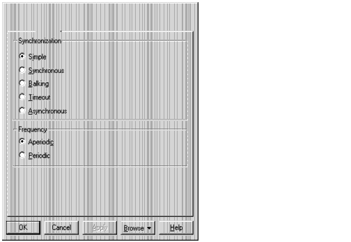

Message Specification--Detail Tab
Figure 80 Message Specification--Detail Tab
Refer to the descriptions in the Introduction to Specifications chapter for information on the specification elements not covered in the following section.
Synchronization
Use these options to specify concurrency semantics for the operation named in the Synchronization field.
Table 14 Synchronization Options
Type
Description
Simple (default)
The message has a single thread of control.
Synchronous
The operation proceeds only when the client sends a message to the supplier and the supplier accepts the message.
Balking
The client passes a message only if the supplier is immediately ready to accept the message; the client abandons the message if the supplier is not ready.
Timeout
The client abandons a message if the supplier cannot handle the message within a specified amount of time.
Asynchronous
The client sends a message to the supplier for processing and continues to execute its code without waiting for or relying on the supplier's receipt of the message.
Frequency
Use these options to indicate whether the message is sent periodically or aperiodically.
Table 15 Frequency Options
Type
Description
Aperiodic
The message is sent at irregular intervals, or does not have a regular interval.
Periodic
The message is sent at regular intervals.
