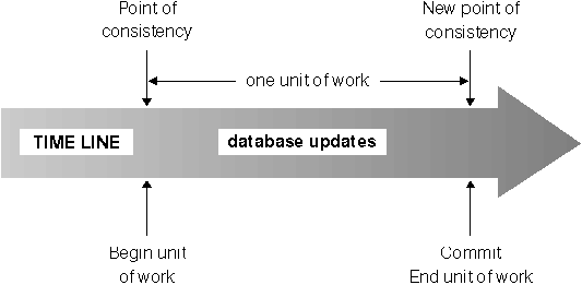

Figure 1. Unit of Work with a Commit Statement
REQTEXT
Such a transaction would require that these funds be subtracted from the first account, and added to the second.

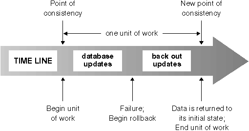

Figure 2. Unit of Work with a Rollback Statement
REQTEXT
Following the subtraction step, the data is inconsistent. Only after the funds have been added to the second account is consistency reestablished. When both steps are complete, the commit operation can be used to end the unit of work, thereby making the changes available to other application processes.
If a failure occurs before the unit of work ends, the database manager will roll back uncommitted changes to restore the data consistency that it assumes existed when the unit of work was initiated.
